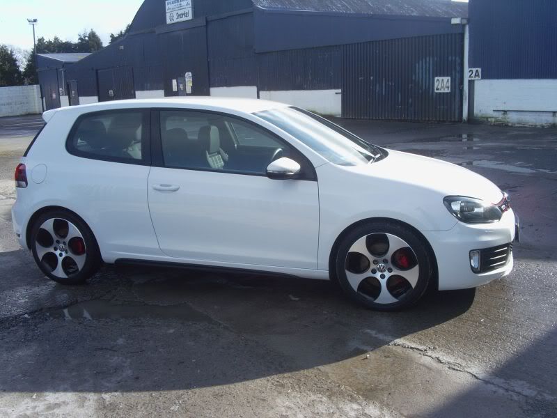

A new White Golf GTI was purchased in December by one of my clients, Dave. I had detailed his previous red Golf GTI to a very high gloss and coated it with Crystal Diamond Glaze.
CDG is one of the great sealants. It lasts well and leaves a gloss to rival the very best waxes out there. But most of all, the owner was impressed with how easy the car was to clean with CDG. So when he purchased the new White GTI, he wanted to get it into me as soon as possible for another treatment.

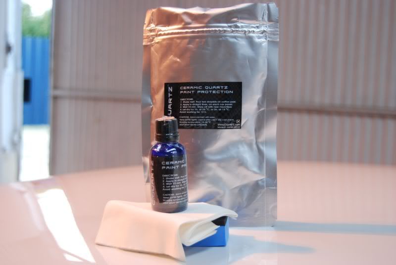

Now, because ease of maintenance is important, I introduced Dave to CQuartz where you not only get easy upkeep, you also get your paint made 50% harder. He went for it straight away. Especially since it lasts for years, instead of months (like CDG) - or weeks (like waxes).

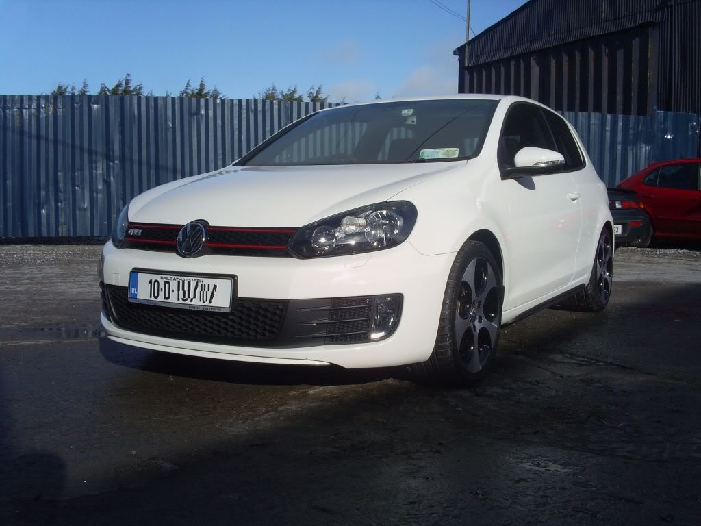

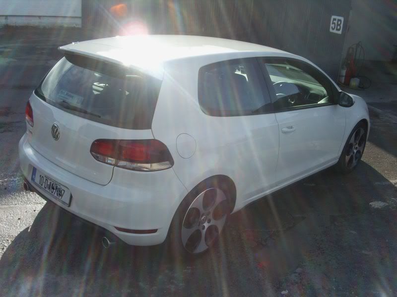

Here's the car when it arrived. One of the problems with hatchbacks is that the muck gets sucked up onto the back in the normal course of driving.

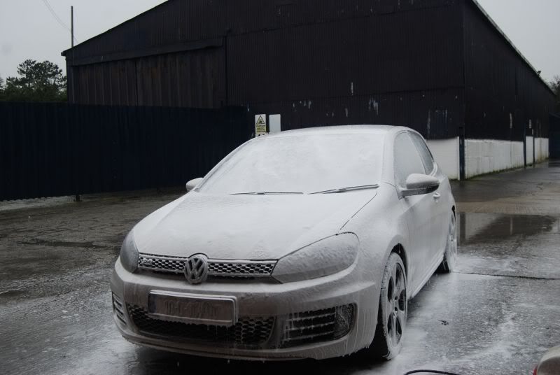

The process begins with a full paint detox to get rid of everything down to even the dealer sealant that is applied in the showroom. Stage A, Acids Neutraliser - an alkaline foaming wash to get rid of contaminants with acidic characteristics.
This reveals any inorganic bonded contaminants. The car is dried and because it was raining hard, I took it into the workshop for the next stages.

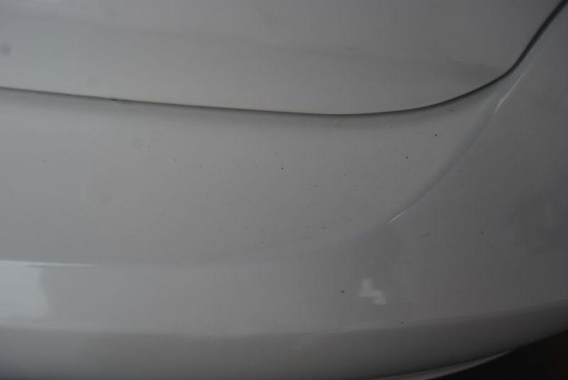

First up, the car was covered in tar:

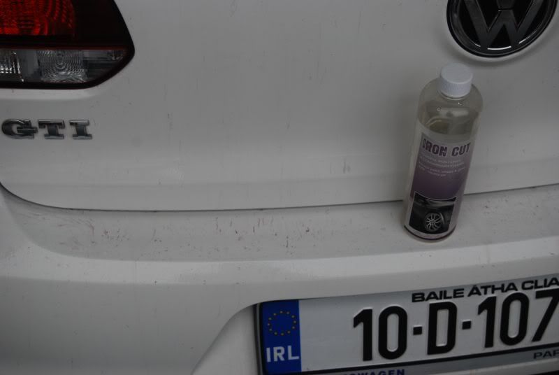

When I cleansed all that away, it revealed something a little more sinister! The rear of the car was covered in brakedust.

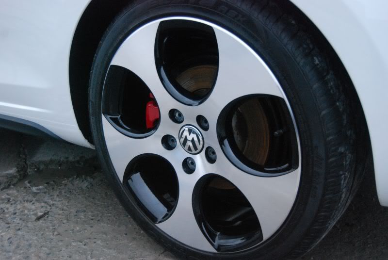

I normally take care of this with my full detox wash, but I wanted to show you another product available to the general public called Iron X. This is designed to cleanse paint and wheels of iron particles. As soon as it reacts it runs purple so you can see how effective it is.

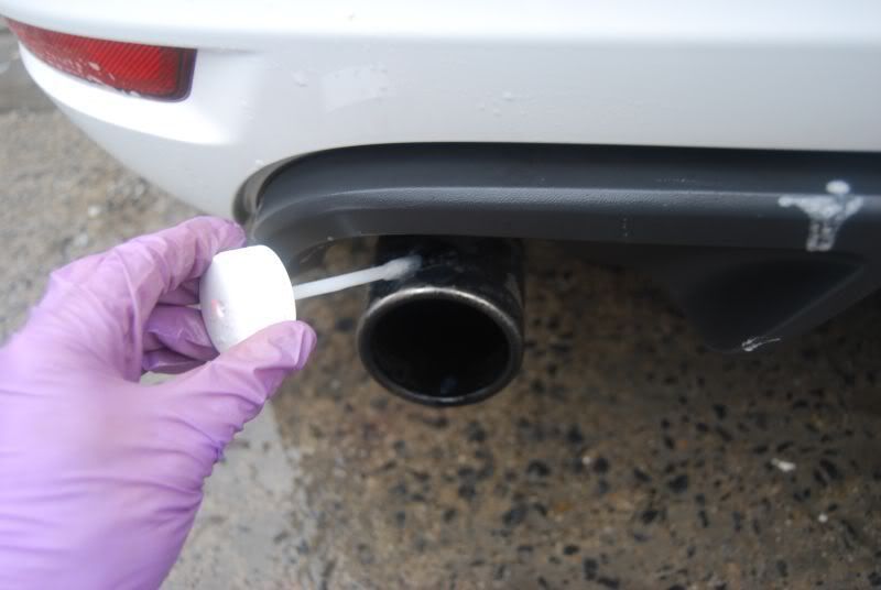

Then back outside where I applied a little carbon-solvent onto the exhaust before rinsing and treating the car, including the glass, with a clay bar.

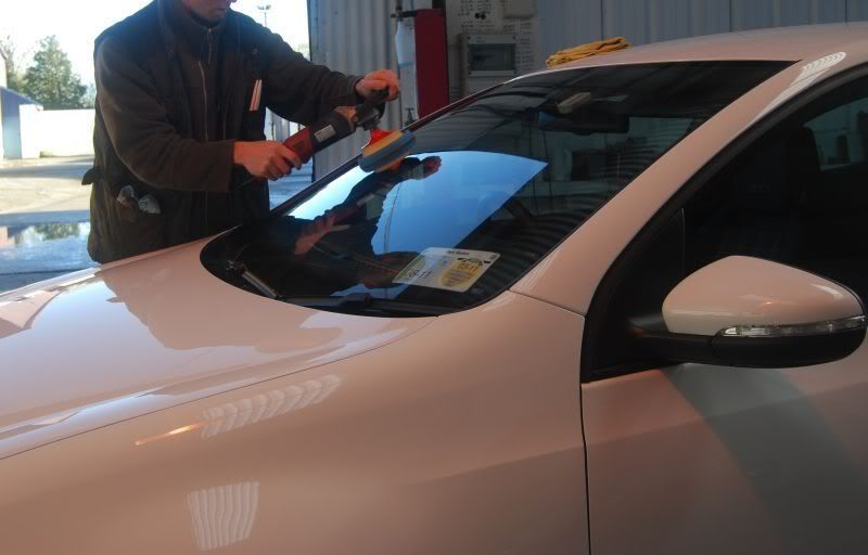

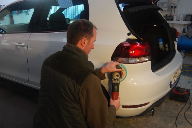

Anyway, polishing of paintwork and glass was next.
The car is then wiped down with a strong IPA / detergent solution to remove any traces of oil from the polishes before applying the first coat of CQuartz to the paint, glass and wheels.

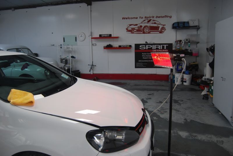

After the first coat, you can already see a more intense gloss forming on the paint.

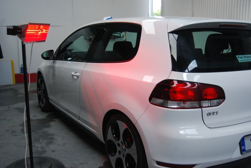

Dried under the Infra Red and let cure for an hour before the next coat is applied. The second coat is to reinforce the first and make the paint even harder and ensure even coverage.

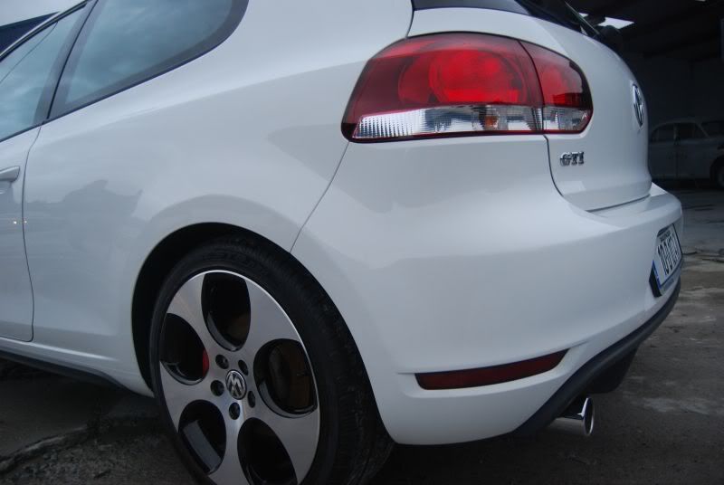

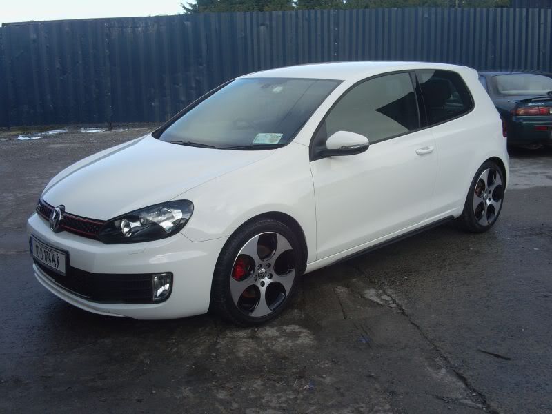

CQuartz coating was applied to wheels, glass, paint and plastic trim. Sorry to go into so much detail but I wanted to establish that it requires more effort than putting a simple wax on the paint. But the pay-off is really worth it. Its super glossy along with the other benefit.

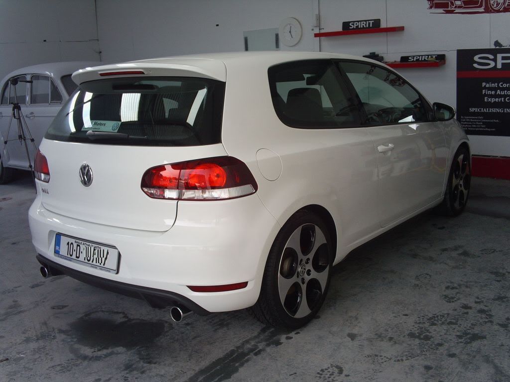

The weather was a bit nuts for taking pics. It was either too dull or too bright for the whiteness of the paint!! :D I was happy the sun came out for the last photos though.... and for the owner collecting. It looked great. :cool:

The paint is terrible on those new yokes though isn't it? I think its the 7th pic you can see a real orange peely texture off the paint.

Hard to get nice flat paint on any production line car these days. Pity. They spray everything so thinly and economically that wet-sanding them to perfection is very dodgy.
